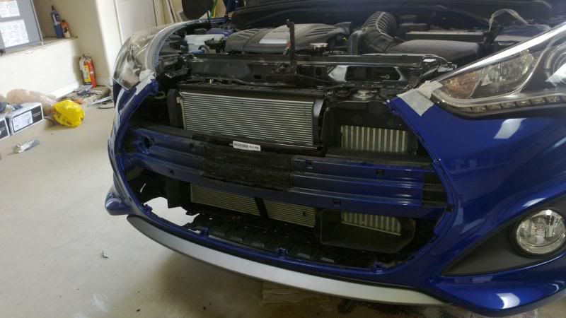

I was just going to change the oil in the VT, but while waiting for the oil to drain, I started looking under the front end to see how easy it would be to take off the grill, and before I knew it, the grill was off.
Just a note for those who want to do this, it looks like its way easier to take off the whole front bumper, I stupidly didnt look at any manuals and thought there was only 4 screws holding the grill in place, when in fact there are many more in the center bar area of the grill, which I broke off.

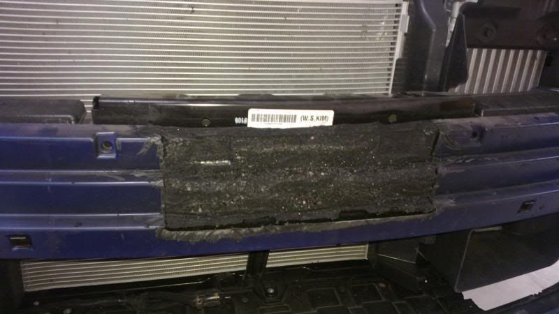

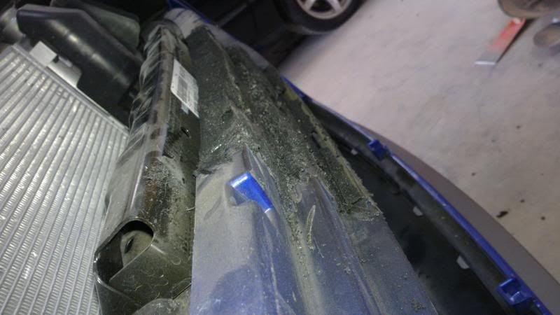

So I was finally able to get the grill out without taking the front bumper off (BIG MISTAKE!)
I should have taken a before picture, but anyways, behind the brick is a plastic brick on the bumper itself which has the impact foam behind it.
I grabbed my trusty Dremel Sawmax and hacked away till the brick and foam were gone from behind the brick on the grill, I then shaped it so it matched the contours of the bumpers bar
