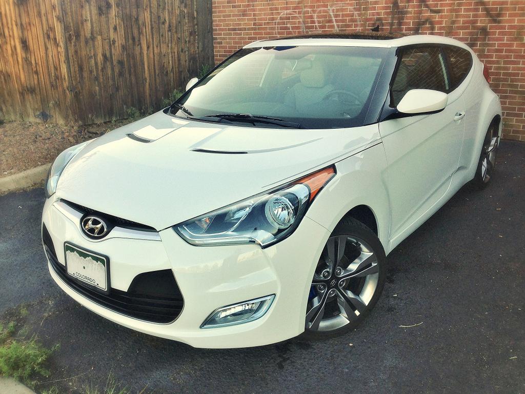

Here’s what I started out with, a 2013 NAV with Tech & Style package:
The platform was very appealing to me. Modern, sporty yet practical, but it was lacking in the performance department, so I traded it for the VT. I’m very happy with that decision.
