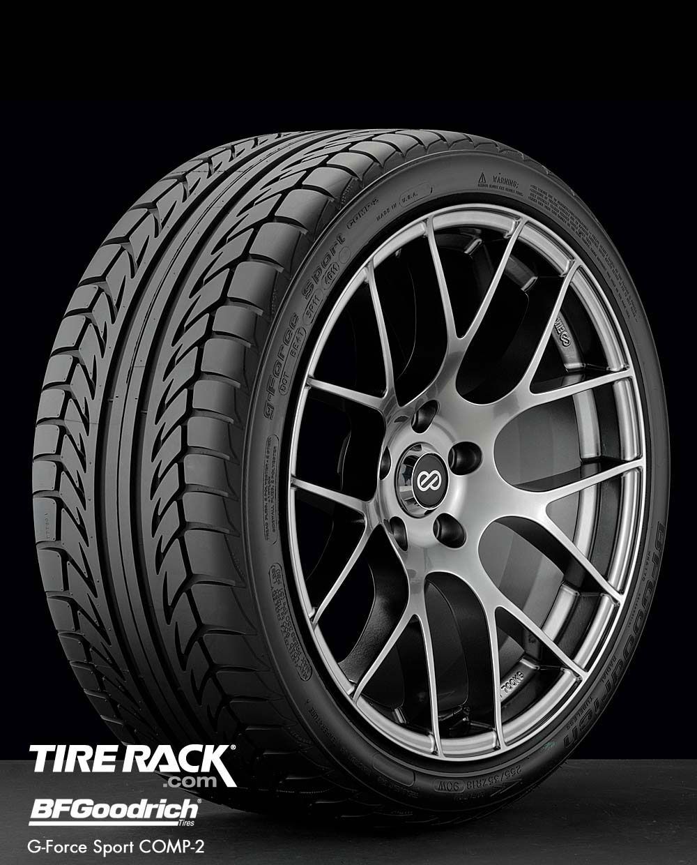

SUMMER:
WHEELS:
TSW Nurburgring RF, Matte Grey, 18x8, 5x114.3, +35
TIRES:
BF Goodrich g-Force Sport Comp-2, 225/40ZR18 88W

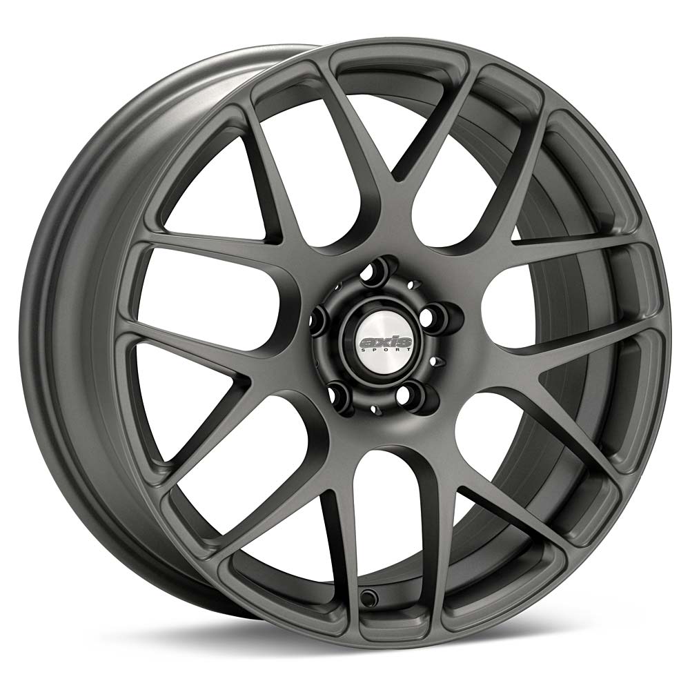

WINTER:
WHEELS:
AXIS Sport XMX, Matte Grey, 17x7.5, 5x114.3, +35

Modding day 8: WINTER WHEELS HAVE ARRIVED!!!
er mah gerd I have wheels. And tires. Which don't suck, and don't weight 9000 lbs each.
Axis Sport XMX in matte silver-grey with Continental ExtremeContact DWS rubber.
