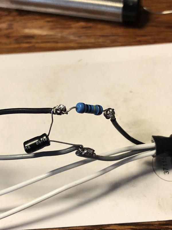

So recently went back to catless after passing emissions and didn't want that little engine symbol popping up again with the typical P0036 and P0139 codes. After scouring the interwebs I located a hack where you place a resistor and a capacitor in the O2 sensor wires. This got rid of the P0036 and P0139 codes even without a O2 extension but now I have a P2270 code (O2 sensor stuck lean), so FML. I'm wondering if a lower ohm resistor would get rid of the code. Just thought I'd share and maybe see if someone else has done this.
Parts:
One 1 MEG ohm 1/2 watt 1% metal film resistor
One Capacitor 1 uf/microfarad 50 v/volt 85C Kemet Radial
... and here's my hack job. Everything was shrink wrapped afterwards and heat shielded.
