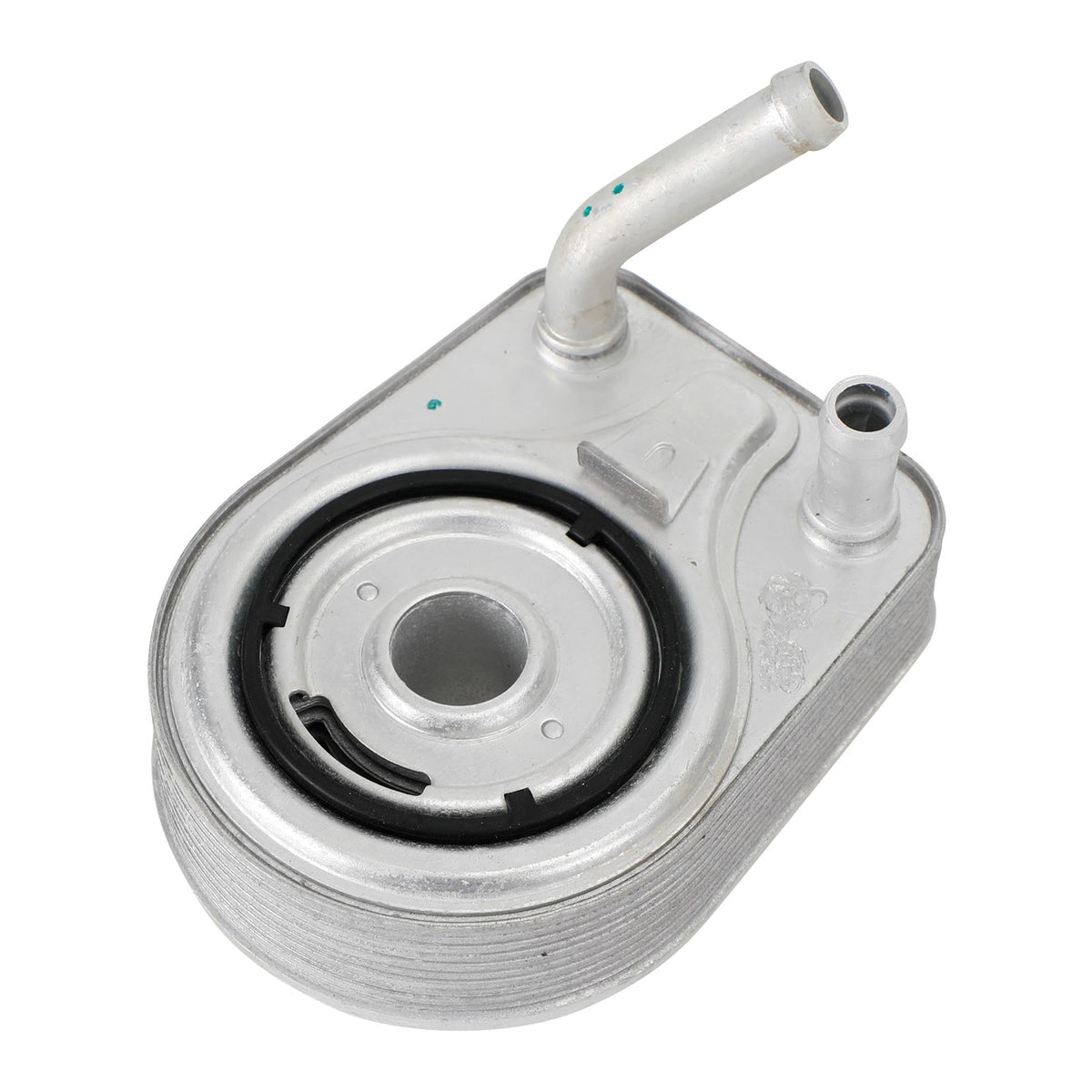

i dont remember which one that is but your oil cooler gasket is failing... have to replace that whole aluminum unit above the filter since they dont make just a gasket. also will need coolant when you replace.

the oil cooler gasket is a thick rubber squared o-ring like a cylinder with notches in it. who knows what kind of junk is inside :)
